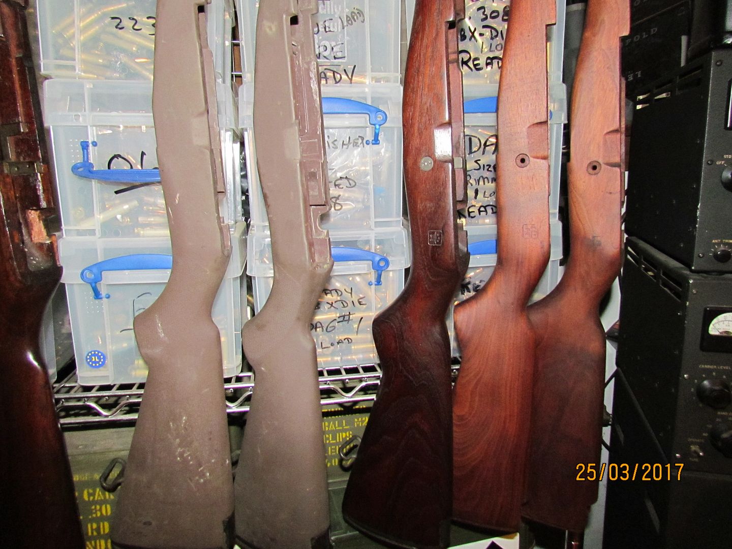

Got 3 presentation grade walnuts in the shop now. Citristripped and in varying stages of BLO application. First couple of applications are 50/50 Blo and mineral spirits. I may even go a week or two between coats. Depends on how bored I get with other projects. Third from the right is about done. First two on right have had a couple of applications and are ready for the straight BLO. Rest of the stocks to the left are just spares.

Posts: 141
And I'm griping about doing one stock...
My stock doesn't have any impressive grain or figuring, it's pretty plain, but I like the way it's coming out so far.
But like my Dad always told me, "It doesn't matter if the world thinks your wife is beautiful, only that you do.".
Good work on those stocks !!
