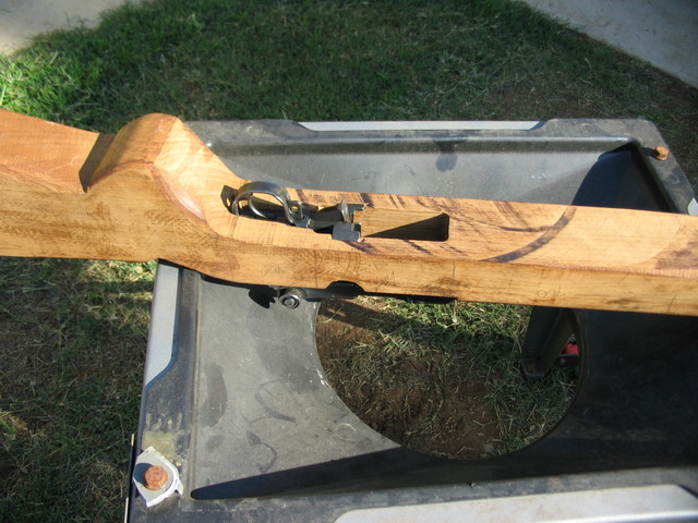

Day One, rough inletting done
Stock is still flat and square. Easy to vise it that way. And makes router and table saw functional to do as much inletting as possible. Keep everything straight and parallel. I'm sure glad I hung on to my 2" stroke plunge router when I retired from woodworking.
In keeping with as fat a stock as possible, I've inlet the front of the floor plate. Not far enough though. I had mistakenly let the rear of the trigger group in to make up for the thickness at the front. 1/16" at the front, means rear is 1/8" too deep. I wondered why I could lock the trigger guard. Lets just say I started drilling for a pillar a little prematurely. ;)
Link to big pics http://photos.imageevent.com/bigchri.../M14%20061.jpg

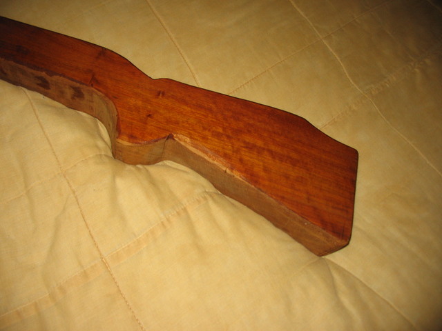

Day Two, Grind it into shape
Fit the butt plate, band saw and then disc sand. Except for chiseling inside, everything so far has been power tools, A 12" stationary disc sander, then a 5" w/ 50 grit, then a soft pad sander with 80 grit. Not done yet, though the shape is there.
It does fit me well. An extra inch of drop at heel, and about 10° of toe out. Plus the more extreme 'pistol grip'.
There is a flat the bottom, for possible rail install. Sides have some flatness too now, but I think I'll roll them inward, a mild 'beavertail' ? Anybody got specs for the rails?
I found a site that has several rails that have screw holes every second groove. My sling swivel mics to 3/4" on center. Should I go ahead and install a few inserts at .750 spacing? Or maybe one 'internal rail' with 4-5 holes, drill only the sling mount holes now, more rail holes later? Plus the internal iron rail would stiffen the stock some too. I found a site that has several rails that have screw holes every second groove. My sling swivel mics to 3/4" on center.
But I do need to verify the spacing. Anybody?
I left about 1/4" around the butt plate. It weighs about one pound more than my samples.
Moistened with paint thinner this time. As the sanding gets finer, I'll wet it with water before the going to 220. The water will raise the grain that may have been compressed by the earlier sanding. Makes it easier to get that final 'polish'. I'll stop at 320, finer only if sanding is needed between coats, which I doubt. I plan on rubbing on a Urethane Spar Varnish, as if it were BLO. I liked the look of the last stock.
Then I can crawl back inside and bed it.
