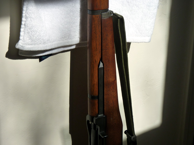

As a newbie starting with his first Garand, a mostly HRA mixmaster with a sanded GI stock, I have to say the timing of this post, not to mention the content, is wonderful. Thank you!
My rifle appears to have been in storage for several years before I recently bought it from a local, private seller. Because the garage is very cold during our mild Arizona winters and my wife is very sensitive to solvent fumes, my stock is just getting a bit of BLO to wake up the very dry wood and I am "working" in a bathroom at the far end of the house.
Even with very thin applications of BLO and waiting as patiently as possible between coats, I have discovered that buffing with a clean old tee shirt really helps smooth out the surface. I guess that is just too basic because there doesn't seem to be much discussion of buffing the surfaces in most of the accounts of methods for the beautiful finishes you guys achieve.

Isn't it amazing how well some things turn out! My old stock will never be as pretty as yours, but the overall color (pictured below) is fine. But, there are a few lighter areas that would benefit from a tiny bit of stain and there is some spirit based, leather dye in the garage . . . somewhere.
Once it warms up, the "wet sanding with high grit sandpaper and BLO" is in my future. I have been working on the wood without removing any metal parts because I hope to shoot again later this week when it warms up.
