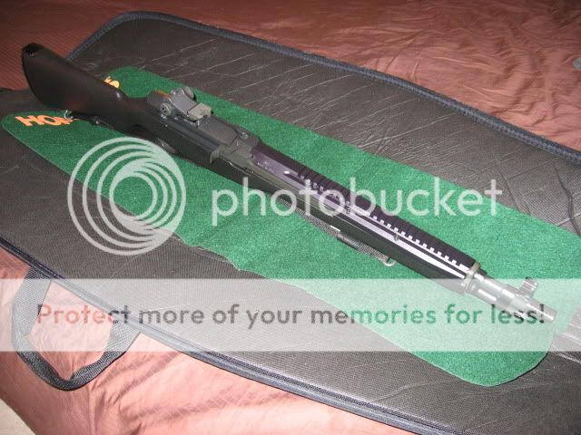

My Socom 16 was manufactured in 2006.
Was a local police officers unofficial "trunk gun", and was barely shot. Picked it up "used" in "09".
Before I shot it I did some mods. Which is not the best thing to do.
I changed out the factory handguard/scout mount with the Ultimak M8 rail.
Replaced the factory spring guide with the Sadlak N.M. spring guide.
Added a Buffer Technologies M1A recoil buffer.
Replaced factory gas plug with a S.E. Socom gas plug.
Shot about 3-4" at 100 yds. with surplus ammo and that brick Springfield Arms calls a front sight.
Put a red dot on the rifle and that got me 2-3" at 100 yards with surplus ammo.
Next Mod was the front sight. Filed it down to a trapezoid. Top width being .072"
Also started to reload for the rifle.
Between the reloads and the front sight mod. Average groups went to 1.5-2" at 100 yds. Best group, 5 shot, has been 1.25" at 100 yds.
Now I do like the factory brake on my Socom 16. So no changing out the gas lock/brake for me. I did a thread for sight options with the original gas lock/brake. Here's the link;
www.m14forum.com/modern-m14/102642-socom-front-sight-options-factory-gas-lock-muzzle-brake-pic-heavy.html
After about 2000 rounds my accuracy started going south. Checked the rifle and found the gas cylinder/front band had loosened up.
Needed to shim the gas cylinder. Since I was taking the gas cylinder off. I took the opportunity to change out the factory gas cylinder to a Springfield Armory N.M. unitized gas cylinder.
With the new gas cylinder I installed a new Sadlak Titanium Nitride gas piston.
No improvement on accuracy, but no loss either.
As the O.P. related in his first post about bullet weight. My Socom prefers projectile weights between 123-155 grains. The 155 grain bullets being the top dog.
Now I have both wood stocks and a couple of the Springfield retreaded USGI synthetic stocks.
My Socom 16 does shoot more consistently in a wood stock. But for hunting I prefer using the synthetic stock.
