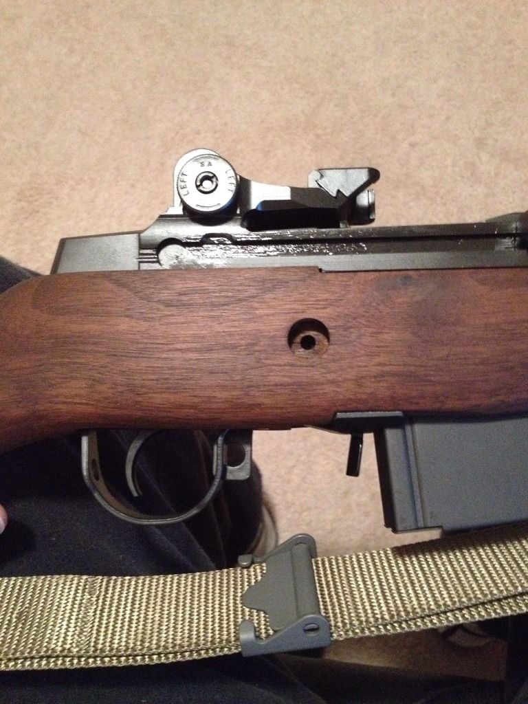

Brand new out of the box, thoughts? I'm not one to run crying back to Springfield Armory...can I add the crossbolt (source?) and get on with life?

I know brownells has the little tools for the, you may check there. That's odd must have been Monday morning or Friday evening. I would give everything on it several close looks.

Of course I looked it over with the FFL that is was the correct rifle (standard M1A) but once I got it home I set to inspecting/cleaning/function checking it and boom...there it...ISN'T. I have email off with the pics to SA.

There is no crossbolt, as found on a Mauser rifle. There is a small spanner screw on each side that holds the stock liner in place.
1. See if the liner is in place.
2. Get on the phone to SAI Customer Service.
You need a special bit/tool in order to tighten the spanner screws. The tool is about $10 and is available from Brownells along with the screws, but this rifle should never have left the factory this way.

These if you don't make them fix it, or send you another rifle!
