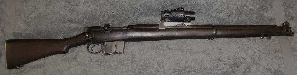

Is it as nice as this one? I picked up this summer. Just had to repair the draws and bed the action.

Well, except for some dinging and scrapes in the wood, it's almost identical. On the downside, I found that there is some cracking in the stock, so not sure if it will be salvageable yet. Anyways...
Just picked it up this morning, and have spent the entire day cleaning off cosmoline from under the foreend, taking off paint, and overall cleaning it up. Actually have the wood wrapped in a garbage bag with a container of boiling water to get some cosmoline out.
After checking over everything, the barrel serial does match, so besides wood it's an all matching set. And under the paint is a pretty good bluing, though it is worn in a few spots, but not to bad. Think I'm going to end up duracoating it all together.
And probably the most pleasant surprise so far, upon cleaning some of the paint off of the markings, it's actually a 2A1. Realized the sights went to 800 instead of 2000, and immediately moved to the strap to make it legible, and the 1 was completely paint filled.
