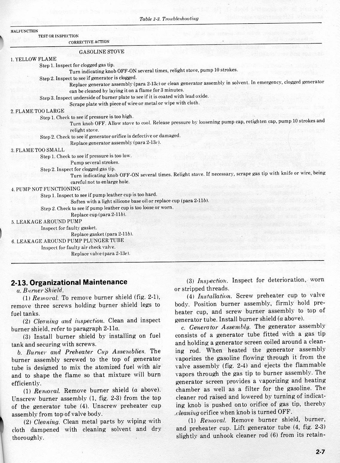

I was digging through some stuff in the garage today and found a old GI gas stove my brother got while he was in the Army.
Its a M 1950 gasoline burner, the cupped washer that was on it for the pump does not fit in the pump tight enough to allow it to pump up, I put the one that was stored in the pump handle on and it does work but would like to have a couple of spares, any body know where to find them? I looked online but all I could find was people asking where to find a whole stove. This one is marked on the side "Coleman 1966" I think I will give Coleman a call and see if they have any but I doubt it.

I called Coleman and they actually have a leather cup washer for the pump, its for some other model but the nice lady I talked to said it will work. They were only $2.50 each so I ordered two.

Earthquake:
Many moons ago I got a request from a guy on another board to scan some pages from the maintenance manual for this stove. They are still on my server so if you are interested, here are links to them (these pages average about 3/4 meg each):
http://users.nikealaska.org/~sustinemus/M1950_Assy.jpg
http://users.nikealaska.org/~sustine...structions.jpg
http://users.nikealaska.org/~sustine...eratorAssy.jpg
http://users.nikealaska.org/~sustine...leshooting.jpg
http://users.nikealaska.org/~sustine..._ValveAssy.jpg
Thanks from Vermin, Butzbach and Earthquake

Sustinemus
Thanks that a big help, I will have to dig through my brother's manual collection, he may have had one.

I received the leather pump washers [$2.50 each] from Colman, they are quite a bit bigger but I think I can make them work by soaking them in warm water and pushing them into a piece of tube I have that is just a bit bigger then the pump and letting them dry.
