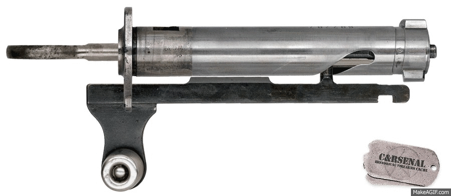

Originally Posted by M11293 View Post
Swiss.
What is it about the K31 that makes it so accurate? Also, what keeps the lugs from unlocking in the action while shooting?
This is the concept Eugene Stoner took to the next level! Straight pull bolt carrier with cam actuated bolt. Just added gas impingement.
