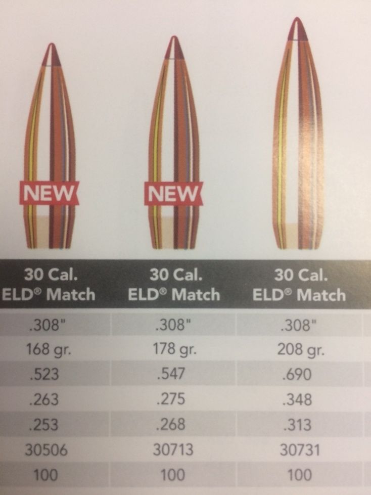

BWHookDvr, the 50th Anniversary Lyman reloading manual has a lot of recipes for the 308W with a 178 AMAX for bolt action rifles, so that data may be useful for you:
(no data for PP-2000 MR unfortunately)
Phil, the original poster is most likely referring to the new 178gr Hornandy ELD-X and ELD bullets (they don't make a 198 grain version, so I deducted he had a typo..).
The reported BCs in these bullets is very high, here's the ELD-X (expanding bullet for hunting, here's the two flavors)
ELD (Extended Long Distance target bullet (178gr):
..just an fyi.
