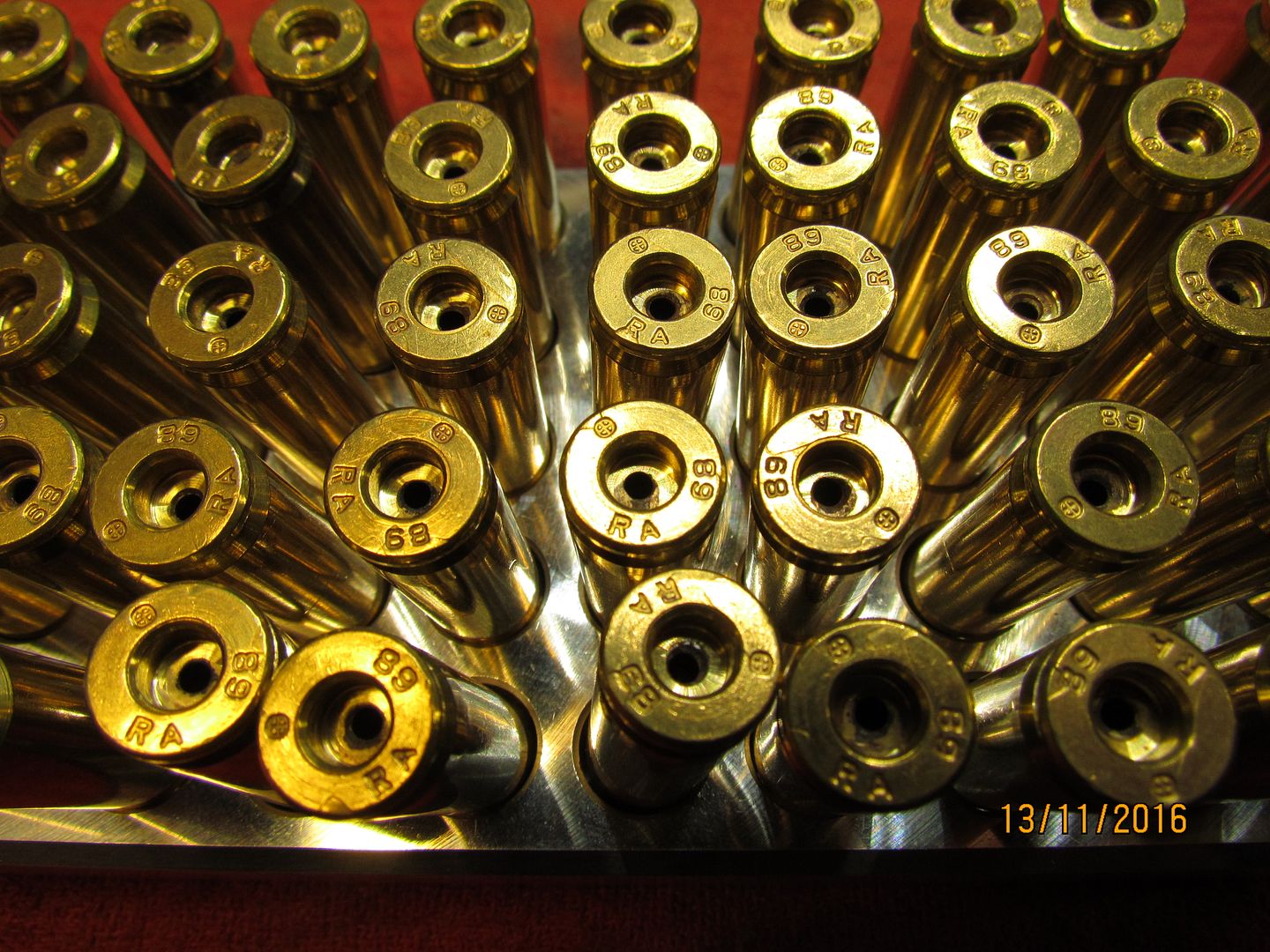

Originally Posted by nf1e View Post
Remington Arms Bridgeport CT.
This was special ammo produced for the Army's point and shoot philosophy. Easier than teaching marksmanship.
Ok , so it was a joke.
147 grn minute of man.
RA is good brass for reloading anyway. I had many K of 68 that came to me linked with tracers in the 80s. Price was right.
http://

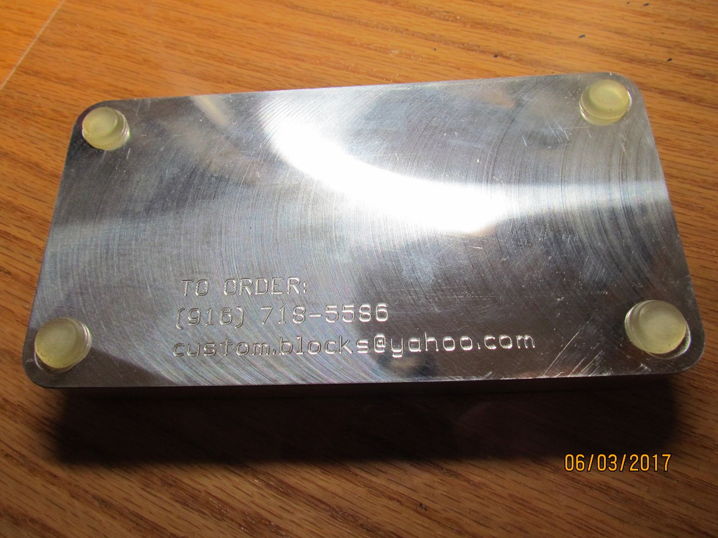

What case tray is that in your pic?
Custom made by a gent out West.
http://
I don't know if he is still around but they are super.
ArtB
