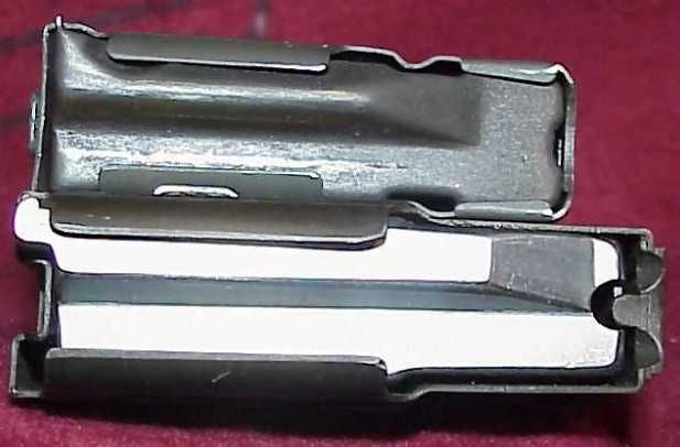

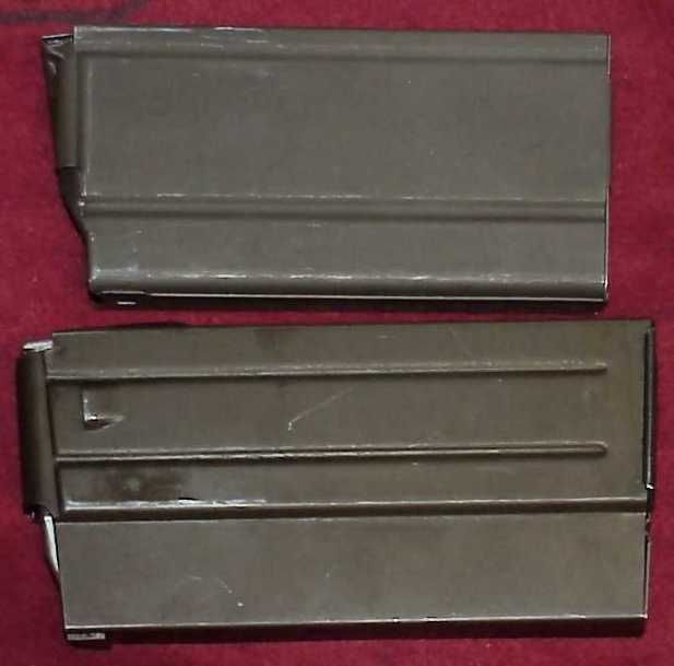

Your guys should take a good look at a original BM59 magazine. It's actually a better designed than the USGI mag. While they won't interchange between weapons they have stainless steel followers and are stamped differently and feel a bit heavier. Hold them up together in your hands and you'll see and feel the difference.
NATO, they look like great mags. Why wouldn't they be interchangeable between weapons? I haven't done any reading on them.
A-they will not fit.
B- Even the well used surplus ones that are recently now in country, cost twice as much as new C.M.I. mags.
sac troop is offline

The BM59 mags are expensive not only because they are rare, but because they are extremely well made. They are much larger than M14 mags because of this. http://www.fulton-armory.com//faqs/M14-FAQs/MagComp.htm
