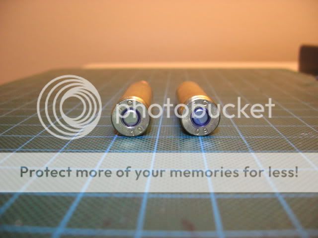

"FC 10" is the T762TNB1. "FC 09" is a XM762D case.

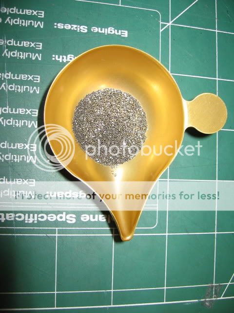

Powder is a Spherical type.
The charges varied
1; 45.2gr
2; 44.5gr
3; 43.2gr
4; 44.9gr
5; 44.5gr
6; 44.6gr.
Cases are of military weight. No NATO markings on cases.
Weights are 181.8gr +or - .4gr with primer.

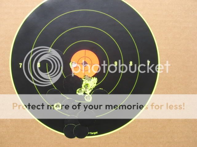

here is how they grouped at 50yds.
Four of the six are grouped together, and me being sloppy. There is a seventh hole that was under a cover dot that got knocked off.
This is from group A. Group B was shot with another load I wanted to chrono so no picture, sorry.

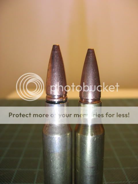

I do plan to deviate from the 2.800" length and shorten the cartridge. Fellow member Bamban had pulled some Malaysian 7.62 ammo and replaced the M80 ball with the MK319 bullet. He set them lower than the Federal T762TNB1 bullets. I plan to do the same thing, which is to set the bullet close to the top of the center band.

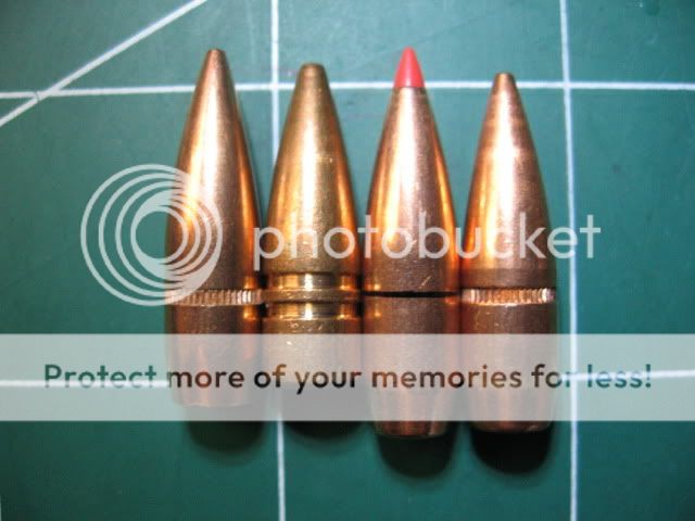

Bullet seating comparison, M80 bullet, MK319, Hornady 155gr A-MAX, 150gr bullet pulled from XM762D cartridge.
With my test case I was able to get the OAL and ogive I needed.
And with the Federal cartridge.
(L)Federal, (R)Clone
This gives me an ogive of 2.180" and an OAL of about 2.742"
Because the ogive on these bullets are more consistent than OAL. I recommend using a bullet comparator for seating these bullets. I use the Hornady bullet comparator.
