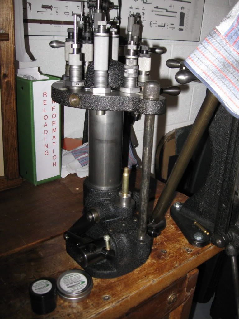

A few months ago I purchased a vintage Hollywood Senior turret press. I absolutely love this press. It was a little more expensive than what I had planed on paying for a press but I got a good deal on it off ebay. New they cost 1k. I picked it up for 425. I was always under the impression that I would not be able to use this press to insert primers. I recently discovered that it is capable to insert them. I often wondered what the 5/16 hex screws was for under the ram, well I finally figured it out, that is where the primer rod gets installed. Well I discover that a guy on ebay makes them and has them available all the time. He sells it with a shell holder as well as individually. Both large and small primer rods. As I was surfing around ebay last week I found two vintage primer rods both sizes. I watched and one them for a decent price. I also discovered if anyone is looking for them, Hollywood still makes them but the guy that owns the company is down for the count with a detached retina.
They were delivered in the mail today and i couldn't wait to see how they worked. To my disappointment something is not quite right, which bring me here to the reloading experts I have come to rely on for advice. I have to tell you that I am using a RCBS universal type H universal shell holder. I think that is the root of the problem. I installed the primer rod and it does not rise through the shell holder far enough to insert a primer. (See pic) I am assuming it is because I am using the universal shell holder. I am not sure if I can use just anyones shell holder because the ram is pretty thick. The stem on the universal is 1.25 inches long and the 1/2 inch deep nut only gets the 1/4 inch purchase on the threads on the stem. It is secure enough in the bushing on the ram, what I need to find out is if the stems on the various companies shell holders are long enough to fit through the hole and if they have enough threads to secure the nut.
So my questions are this, do you think it is the universal shell holder that is preventing the primer rod from going all the way up into the bottom of the case and does anyone know if there is a standard length for the stems on the various companies shell holders. Here are a couple of pics to describe what I am talking about.
The mystery nut below the ram
Primer rod in place on the press
close up
Pic of the ram fully depressed on the universal shell holder, notice it is not coming through the shell holder
Any thought would be appreciated

I haven't used a press to prime cases in at least 30 years. Looks like you have to put them in that contraption one at a time. Next thing Warren , you are going to be looking for a steam engine to power the thing. My suggestion is to find a nice hand priming tool. Either an RCBS or one of the others that hold a hundred or more primers and go to it. It is nice to "feel " when the primer is bottomed out. Looks like maybe the primer rod on your press is adjustable. You may only have to screw the primer bar a little less into the base to get it to work. Don't hurt yourself.

Warren, Because you are having to remove the primer crimps on the brass you have. I also recommend a hand press. I use the RCBS hand priming tool.
The concern I have with using your press with this particular brass is if you do not remove enough of the crimp you can damage the primer or have it go off while you are seating it.
On the other end, the primer pocket is a little too loose and it is hard to get a good feel for seating the primer with the press. This will lead to hot gas getting around the primer and damaging the surface of your rifle bolt.

Warren, since you have all the accessories for the press, you might as well play with it awhile. I'm also thinking that adjusting the mystery nut will allow your rod to move further up into shellholder. I'll agree with geepee that it is harder to get a feel when the primer is seated thru the press handle than it is to use a hand primer tool. I use the RCBS Universal tool while watching TV. Never had a problem. dozier

The mystery nut gets removed from the press and the primer rods get screwed in. I just have to laugh hard with you comments about by dinosaur. It is so funny. I am still smiling. Now you have me wondering if I can put a steam engine on it, there has to be an attachment somewhere out there I will keep my eye open on ebay.
I did manage to get hold of the guy that makes the primer rods and shell holders and sells them on ebay. He knew what the problem was right away and explained it to me. There is a dimensional difference between the redding, rcbs, ect universal shell holders and the hollywood shell holders. I am waiting confirmation but it sounds like I can purcase his universal shell holders and use them on my rcbs universal h type ram holder and or buy the individual standard shell holders he makes. Either way it sort of defeats one of my ideas about resizing the brass using the redding competition shell holders and priming on the down stroke. I will have to do it in a separate operation now. I seriously don't mind taking my time doing these different operations.
I was wondering about my brass and weather or not it is crimped. It is commercial winchester brass that Black Hills uses and I really don't see any crimp on either the .223 or 308 brass. I am a little concerned about what was mentioned regarding hot gasses passing by the primer. Bolts are not cheap and I dont want to have to lap another one into the receiver if I dont have to. I plan on getting a primer poket uniforming tool. Seems as though this might make the pocket even looser if done wrong that is if they remove material from the sides, I figure they dont.

OK I have one of these beasts. I'll check tomorrow if what I say is right. The press uses its own shell holder, I have several all diferent sizes, they screw in and you need to change them when you go to another caliber. If you have these your in good shape. I found it to much trouble and now use a hand primmer. Like I said I'll double check tomorrow after I return from the gun show.

Thanks Al! If you do find that you have a couple of original Hollywood shell holders do me a favor and check the inside diameter of them. I'm hoping it reads .308-.310 or 5/16ths. Have a good time at the show!

Yes I was right, in the picture you see the primming arm through the shell holder. Also in the picture is another holder setting near. And the universal, what you could do is drill a larger hole in the RCBS or other brand shell holder to allow the primming arm to pass.

I also have a Senior Turret (and several other Hollywoods).
The problem is either:
A. The primer arm isn't long enough. Hollywood made different lengths for their different presses, and I can't remember off-hand if the one made for the Senior is the same as for the Senior Turret, although I believe it might be. I am at work now and can't check.
B. The primer cup is too fat and won't fit thru the hole in the H-ram. You have an original primer arm. Aftermarket arms available on Ebay (I have one) have thinner walls. Lots of companies made shell-holders like these for their early presses (Hollywood, CH, RCBS, Lyman, Wells, Texan, etc).
I use a universal H-ram made by CH, as well as Hollywood single-use shell-holders; don't have one made by RCBS.
I will check and get back to you.
Also, if you are missing your tie bar, I know someone who makes them and should have them for sale on Ebay shortly. He is sending me one to make sure it is the correct length. I just resized 1k .308 cases fired in a MG and had to use the tie bar-equipped Senior Turret to get the cases to the correct dimension so my M1A would take them. All my other presses flexed.
Lastly, if you want a Hollywood shell-holder for .308/30-06, I may have extras. They are also available on Ebay (#1 size).
Note to all: Anyone wanting to know more about Hollywood presses should goto the Cast Boolits web site and look in the Reloading section. I am active there.
Post Script: I looked at that second picture and saw that the Senior Turret has its own primer arm. However, the shorter one "might" work. More later.
