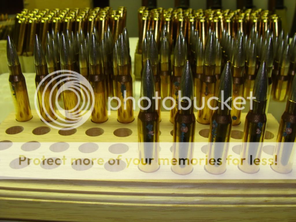

Well I opened my last battle pack of Men 94H0008. Although there was no sealant on the brass, this is what I found.
15 pitted
77 with light to heavy green corrosion
108 good to go
[IMG][/IMG]
This was typical for the rest of the battle packs, opened previously, except for one. It had around 30 pitted and more of the green corrision.
Thanks for all the replys.

just to be clear...so that usable ammunition is not unknowingly wasted.
The rounds with green / blue-green corrosion appear to be essentially cosmetic in nature and that green / blue-green corrosion in your investigation appear to not penetrate the cases and that it is up to the user to determine their usability.
The cases with the pinkish corrosion have been shown to have penetrated the case walls and are not safe to use because the severity of the penetration and it's effect upon firing has not been determined.
cheers..
