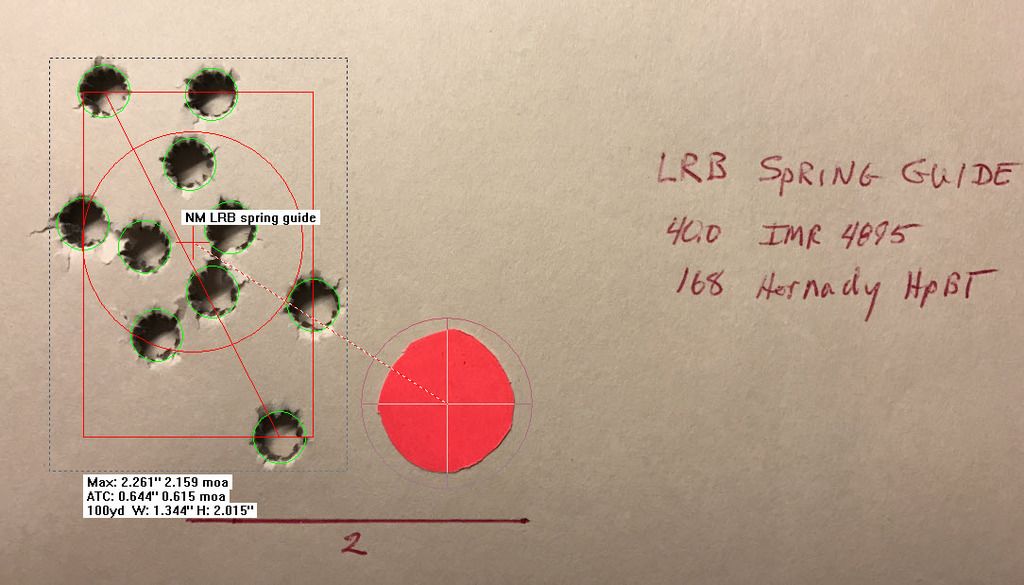

As planned, I pulled the rifle apart and installed the LRB NM spring guide. Since the rifle is glass bedded it made sense to fully clean and lubricate the rifle while it was separated from the stock. Any and all of this activity could affect accuracy, at least for a while.
Temperature at the range was -1F this morning, so I kept the ammo in the clubhouse and went in to load the mag any time in needed to.
I fired three shots to foul and warm the barrel and to seat the action. However, all three went into the previous point of impact, so I felt that no further shots were necessary before starting the test.
The attached table and picture show that my group sized increased slightly with this change. The negative result could be due to the spring guide. It also could have been a function of the cleaning, tear-down, lubrication.....
https://drive.google.com/file/d/0B3v...ew?usp=sharing
[IMG][/IMG]
While I'm tempted to but the USGI guide back in, I'm going to leave it as is and move to the trigger for the next test, rather than disturbing the rifle again.

A single group really isn't enough to draw conclusions from, especially as you approach the point of diminishing returns. If you shoot multiple groups with the same ammo and rifle configuration, it is pretty normal to see some smaller groups and some larger, maybe +/- 20%. So in a single group, you don't really know if that was a smaller one or a bigger one. Military acceptance testing for an M14 match rifle was generally based on the average of 3 consecutive 10 shot groups.
IMO a couple of other things to evaluate in the group, which are somewhat subjective, are the roundness of the group and occurrence of "flyers." The groups you are getting are pretty round and consistent and are not showing random flyers well outside of the group, that's a very good thing and I definitely think you are on the right track to a really good rifle and load.
I'd rather have a rifle that prints consistent round 1.5 MOA groups with no flyers, than a sometimes 1 MOA rifle that throws occasional flyers out to 2 MOA. Or that shows horizontal or vertical stringing. Those are indicators of something that needs to be fixed.
I also think you are on the right track with trigger work next. Just be sure to have a talented M14 smith do the work, you can mess up a trigger pretty easily if you don't really know what you are doing... but the good news is that can be fixed with money, just replace the buggered parts and start over.

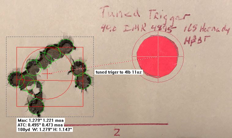

After Saturday, I went home and worked on my trigger. I was breaking at 5lb 8oz with quite a bit of travel in the second stage. Ended up with 4lb 11oz. First stage is 3lb 8oz and I wish it was a bit heavier. Never the less, it felt quite good. All the previous mods are still on the rifle. Group improved a little.
[IMG][/IMG]

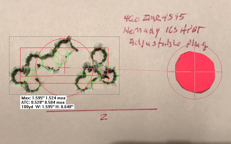

After shooting my group with the tuned trigger, I went ahead and installed the adjustable gas plug. Set it to just cycle the action, no more.
Group shot well, although slightly worse than before. Too close to say for sure. The impact point did move slightly up. Brass now ejects to 5 o'clock vs 1 o'clock from before.
vertical spread was quite small.
[IMG][/IMG]

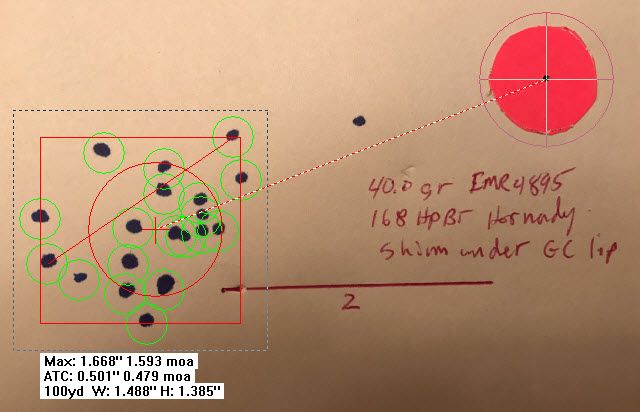

As delivered, this rifle was bedded. The barrel draw at the front ferrule was set to what I'd probably describe as the "minimum acceptable" amount of draw.(subjective of course) My new unitized GC fit such that there was only the slightest amount of pull. At that time I had added enough shim between the GC lip and the Ferrule to make it like the original GC.
Since I'm still waiting for my pin reamer, I decided to add a little more shim to see the effect. I decided to shoot 20 shots (4 strings of 5 from the mag)speculating the resulting effect to be small if anything.
The results were positive on my key parameter of "mean radius". Overall max group size continues to hover just over around 1.6MOA.
Please note that I broke my (self imposed) rule about ignoring "flyers" as I believe doing so usually results in erroneous evaluations. However in this case I had 1 shot that was over 3.5X the mean radius and distinctly out of the group. I have not seen any other such flyers in the previous 100 shots for record so I feel justified in removing it from the test results.
Here is the composite evaluation of the 19 shots. The round at the high right was removed as described above.
[IMG][/IMG]
